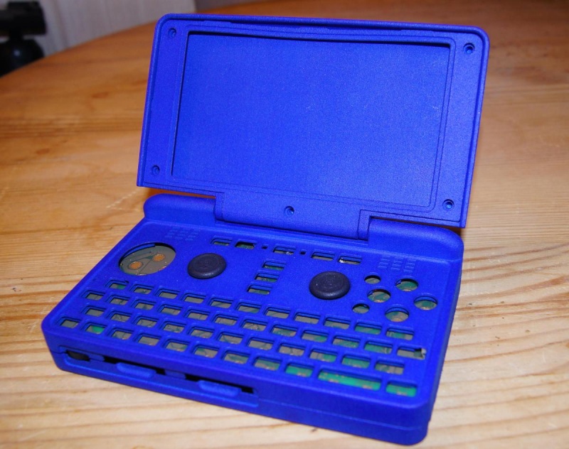

4. Case design
As you already know, a basic case design is finished that's good enough for testing the available space for the CPU PCB as well as seeing how well the main PCB does fit in.
Of course, it's far from being finished, and while Nikolaus will use that one to continue working on his PCBs, the case designers are working on the remaining details.
They'll now work to implement the logo in the lid, add the shoulder buttons and do some minor tweaks of issues we found (though those actually are not many!)
First they'll finish the keymat design though, as that's needed to find a company that produces the keymats for us.
I've added some nice hires shots of the current 3D printed case for you
![happy](/users/1813/17/26/68/smiles/617284.gif)
